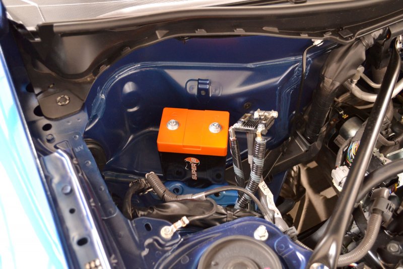

這電池看起來真的減重不少耶!
OEM BRZ battery= 29.6 lbs.
Super B 10P Lithium Ion Battery= 3.9 lbs. (official factory stated weight)
Weight savings= 25.7 lbs.!
http://www.essexpartsblog.com/news/Save-25-lbs-off-Nose-of-your-FT86
http://www.essexparts.com/shop/lightweight-lithium-ion-batteries/super-b-10p.html
